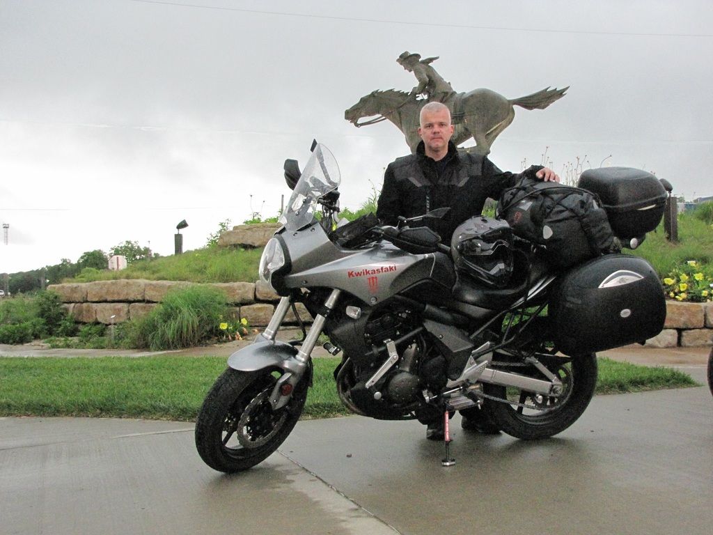

Sorry, no good close-ups, but you can see a strap in this pic coming straight down the front to the trellis frame. I have four straps that clip to mount points on the dry bag. the other ends are just loops. So it's just a simple matter of pulling the clip end thru the loop around any mounting point. Easy wear on the finish, secure and simple. I se the trellis at the front and the Givi side rack cross bar at the rear.
The bag just sits on the seat. My Adcox seat is pretty slippery and that still works just fine. I would never use bungee cords. I never have, but I've seen other riders struggle with gear slipping and shifting all around under bunjees.
