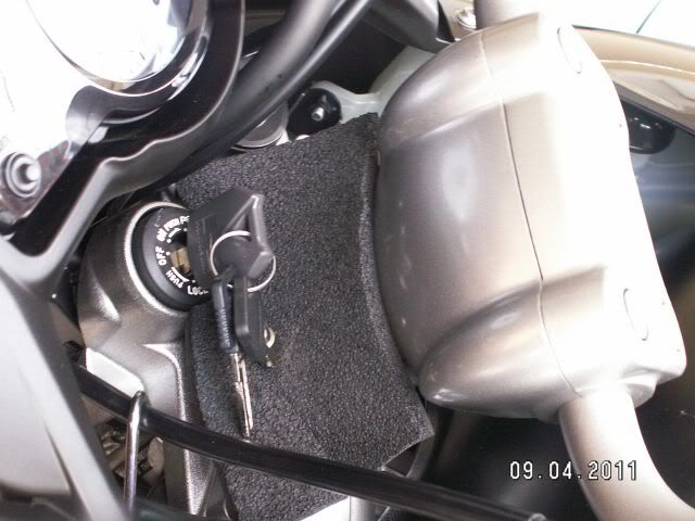

Finally, to protect the handle bar center stem from being scratched by loose keys. Using the same Superlon foam.
You're kidding, right?

You have a better idea? Let me know
Take the other keys off that key ring
Reply With Quote
  #14
Old 04-10-2011, 06:02 AM
2daMax's Avatar
2daMax 2daMax is offline
Location: Penang, Malaysia
Posts: 1,105
Default
That was the original idea but I carry 2 other locks for the bike. I had some plastic stickers for windshields that will be nicer but was too lazy to cut out the shape.

My keyring scratched the hell out of my previous bike, so on my V i have nothing other than the key itself. My u-lock and pannier keys stay in my pocket.

You can always just slide on a piece of tubing.

I have had a few bikes in the past where the "dash" had gotten horribly scratched up from keys rubbing it and it really bugged me. On my past few bikes, I have resorted to just using the one key and not worrying about it. On my V, I have a top case and I want the two keys to always be together. I just wedge my top case key behind the little metal loop that guides cables right next to the ignition and it works for me.
What kiwi said for one. Your solution just kinda reminds me of an old skit on SNL: The anal retentive carpenter. Just overkill IMO, but hey it's your ride, just have fun and ride safe.

Whatever works for you, but IMO that foam piece is way overkill and looks bad.
I would apply a piece of clear self adhesive "sticker," (they sell it for dirt bikes and I am sure other places as well) or even a 3" strip of silver duct tape directly on the top clamp...either would do the trick and be WAY less noticeable.

Great idea on the Silver Duct tape. Thanks guys for the ideas. Those foam were left overs, and they happen to be handy. Agreed, they are not the best ideas for scratch proofing. Another idea is to leave the lock keys under the seat. But with the top box which will be my next add on, I'll still need to have the keys with the bike keys. Can't leave them separate else, I may forget to bring the box keys and arrgghhhh.
