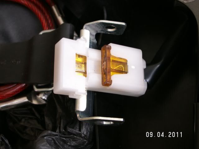

Lastly, I needed to make sure that there's a fuse to all this. Below the seat, there is a 5 Amp fuse which protects the 12V Cig Socket circuitry. I removed the fuse and the HTC LED went dead.
So I have question about this accessory jack that we can use for the 12V socket...
You said that there is a switched wire there right ? and that you've found the fuse for it... so which relay is it running on ? and so why is the original Kawasaki outlet (part number 999940194) ) needs a relay to work ?
sure got me confused - thanks for a ll the hard work and the documentation.

"So I have question about this accessory jack that we can use for the 12V socket...
sure got me confused - thanks for a ll the hard work and the documentation."
There are 2 different things. By default, the Versys 12V socket does not have a relay. The part you quoted is a ADD-ON accessory that requires a relay. This relay appears to fit directly onto the 4 socket plug. Of course, it cost a lot more that a DIY solution. For the 12V socket to work, it needs the relay which are ordered separately.
The method I use, does not need a relay, and for the purpose I am using it for are just for powering up low Amps devices. For higher Amps, I will choose to run a relay and connect directly to the battery, add a inline fuse and a switch.
